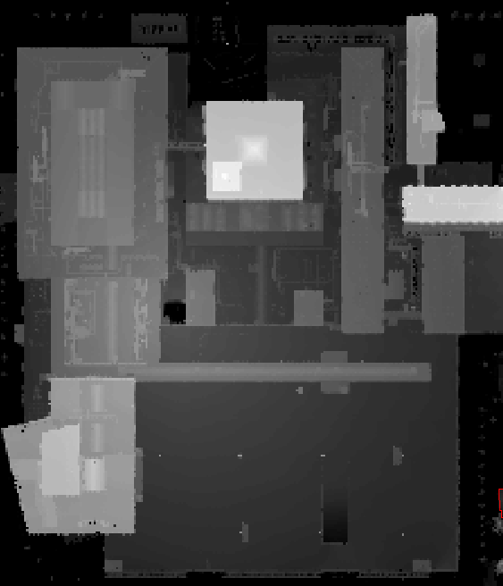

Hi, is it possible to divide the underlying map layer so that a great building polygon , could be split up as well, and extrude each part to the underling layer height?
A big mall is usually a flat roof, but in many different heights.
This doesn’t have to be precise, but just to indicate that a lot of things are going on

How many buildings do you need to do this for?
DavidWasserman
HI Kenneth,
If this is a Raster from Lidar, the work around I would suggest would require some raster processing. What I would suggest is either doing some reclassification or statistical processing to create new polygons. So the work flow would be to reclassify each so that each change in height creates a new set of raster cells with the same value. When you have these raster cells of the same value, you can convert them to polygons and keep their height attributes. I would then extrude the new polygons downward until the occlude with the shapes below (assuming you fill polygon holes, you can collide with terrain to I guess). Then I would treat each shape/model as something that needs to be textured in a similar way to the rest of the building. This will increase the start shape count, but it could...maybe represent this. This is just a throw away idea.
Another way to do this is to treat the base shape as a raster in CGA...This will be brutal to process but I am literally suggesting creating a raster splitter where you split horizontally and vertically in equal measure (same size as your cells perhaps? ), and then sample the heights directly from the raster and each shape should extrude  in a blockly way to the value you want. It will not handle angles as well as the solution I mentioned above might, but it might be faster.

I’m glad I’m keeping your mind busy David 😉 In the city I’m testing it on, it would be around 3 to 4 buildings in total and maybe only 1 is important.
My thought was just to create blocks inside the building polygon for around 10 x 10 m and then extrude each to the value of the raster, then delete as much overlapping polygons as possible.
The easiest way would be to split the polygon directly in ArcMap, whenever there is a new building height, and maybe do this automatically as you mentioned David. Why I thought of this the way I did, was because, after I ran my model in ArcMap, where I’m creating left, right height and so on, I’m stocked if I haven’t thought every building thrue, that could have a flat roof with a lot of variations. So my plan was to try and create the process within the rule like : This building looks a little strange, change the attr to use a map layer, and then I just needed a raster for that exact building.
For a process like that, is it possible to split a polygone inside CE and have the splits become new shapes, that that individually would take the value from the raster. Then I would only need 2 attributes.
As I hear it, that is not a possibility?
