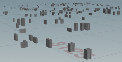

I hope to use cga in building generation in big cities. I connected 1200 buildings in the test process, and the result was wrong. It was correct to connect only dozens of buildings, so I had to try to use foreach. There are about 400000 buildings in the scene I want to generate, so I need its calculation process to be as fast as possible

Thanks @biaozeng, for providing the reproduction data.
The issue is caused by not separating the footprint geometries. Therefore the rule package (rpk) is applied on a single big geometry that fails to fully generate.
To fix this, add an additional attribute "primCls" with the value "$PR" (Primitive Number) before assigning the rpk:
This will lead to the correct result:
