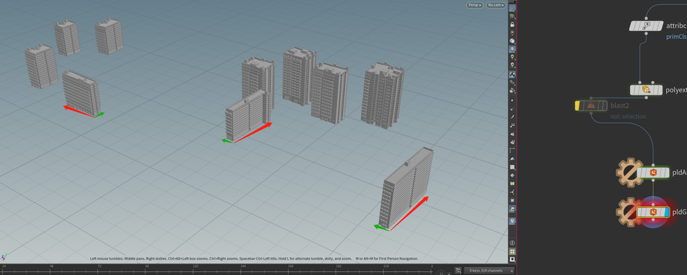

The scope showed different resultsQQ截图20230423094718.jpgQQ截图20230423094347.jpg企业微信截图_20230423094328.png

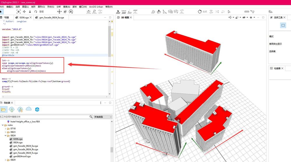

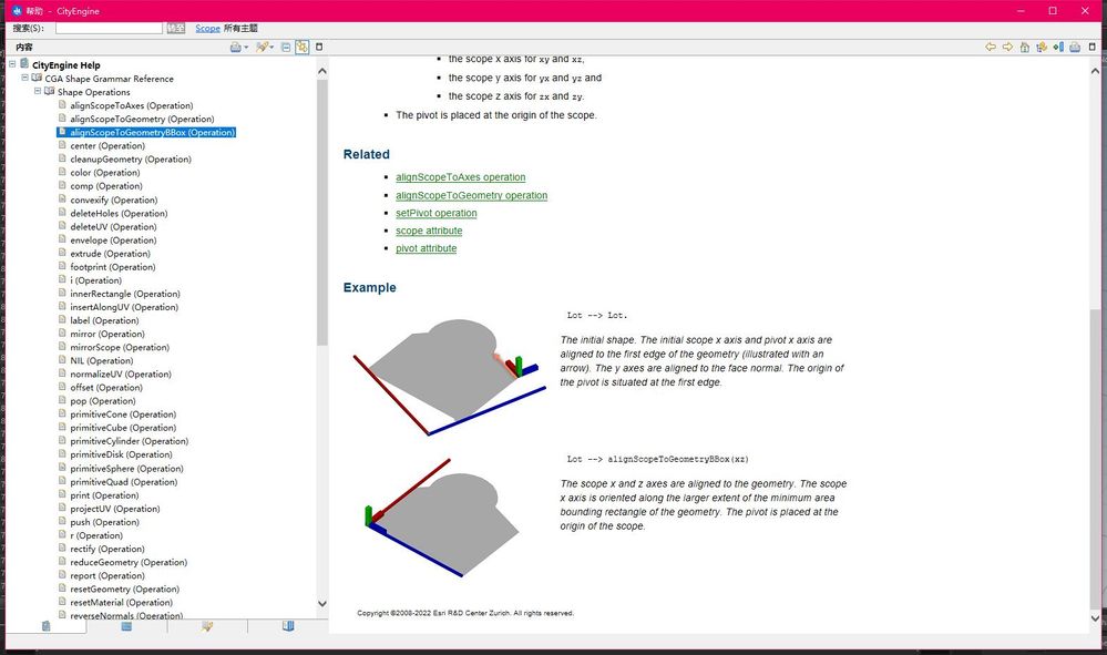

biaozeng
I use the size of the scope to determine the front and sides of the building. If scope. sx>scope. sz, then x is the front, and if scope. sx<scope. sz, then x is the side. Then, different elevation rules are applied to the front and sides, and this operation is correct in cityegnite. Package this rule into Palladio encountered an error when running in Houdini. Please refer to the comparison screenshot I uploaded earlier
