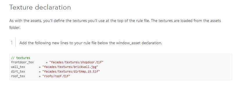

The file paths described in the tutorials online do not match the file directories that are downloaded from the help>'Download Tutorials and Examples' tab in CityEngine Advanced 2016.0
I've only checked this for Tutorial 6, but i expect that the problem exists in other tutorials...
EX:
On the site the path is given as:
// textures
frontdoor_tex = "facade/shopdoor.tif"
wall_tex = "facade/brickwall.jpg"
dirt_tex = "facade/dirtmap.15.tif"
roof_tex = "roof/roof.tif"
but the correct paths from the downloaded assets are:
frontdoor_tex = "facades/textures/shopdoor.tif"
wall_tex = "facades/textures/brickwall.jpg"
dirt_tex = "facades/textures/dirtmap.15.tif"
roof_tex = "roofs/roof.tif"
ThomasFuchs
Thank you very much Phillip!
The corrections will be added soon.
PhillipRobbins
Deactivated User
Thanks Thomas, just FYI... there are actually several errors throughout the tutorial that I've come across. If you guys have an intern or someone with some time on their hands I think it would be a good idea to go through the tutorials from start to finish in order to find the mistakes.
But otherwise, i found the tutorials very well made. Thanks for your help.
