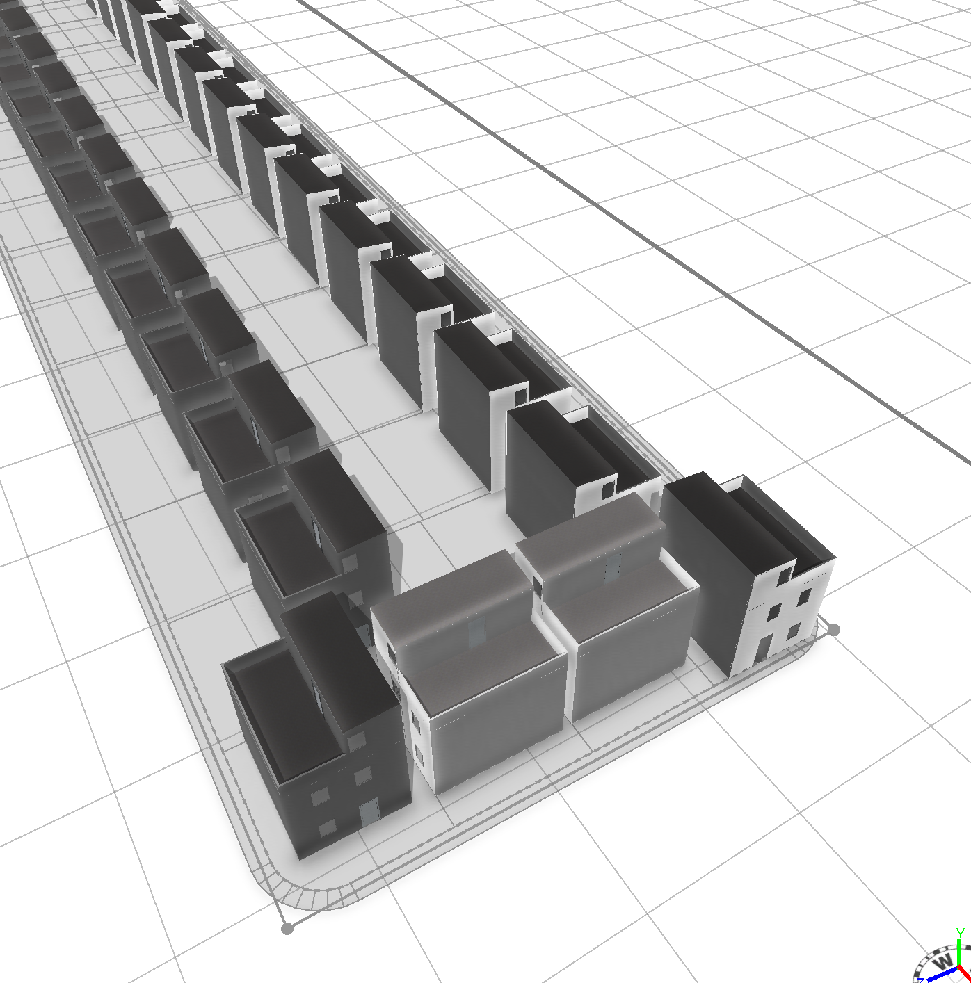

Hi,
I am inserting an .obj of a house into a "skeleton" block using:
Lot -->
        s(0,0,0)
        i("3D Models/my_house.dae")
        center(z)
But the houses end up facing different directions:
Houses facing in different directions away from street.
How do I make it so that they are all facing the street?  The scope and pivot are very confusing to me.
Thanks!
-Robert
CherylLau
It looks like all the buildings do face a consistent direction.  It seems like rotating the scope -90 deg before inserting the model might make the door face the street front.  However, a better solution would be to rotate the model 90 deg so that the x axis is along the back of the house and the z axis is along the left side of the house, and then resave the dae file.
Note:  After a block subdivision, the scopes of the lots are such that the x axis is in the direction of the first street front edge (that is, one of the edges that touches a street) but positioned at the back of the lot.  The z axis is perpendicular to it and points towards the street front edge.
