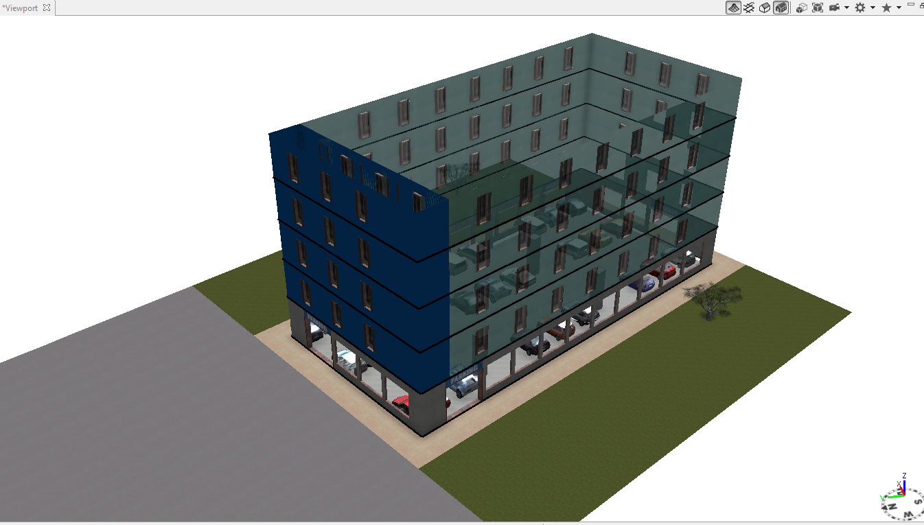

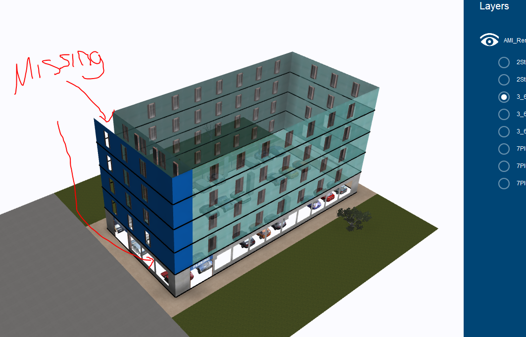

I have an awkward situation where I need to see through a semi-transparent building using the CE WebViewer.  I can see everything fine in the viewport, but after I export and upload my .3WS file...the "wrong" side of the faces are no longer visible.  Is their a work around?

This is because the web viewer does "backface culling". It does this for performance reasons. One thing to do is to turn this on in the CityEngine viewport inside the gear menu - then you will see it as it will appear in the Web Scene. Then you can identify the faces you will need to "fix".
To fix, right after making the face in the CGA, make a copy of the face and move the face in the direction of the backface, very slightly, like 0.01 meters or some small amount, whatever it takes to avoid face clashing. Then do reverse normals, so that the front face shows where you saw through it before.

IT WORKS!!! Thanks! worked for all windows and floors, but I could not get it to work with my outer walls , However, I found out if I apply a small amount of opacity (0.99) to the wall...it shows up at all angles.
