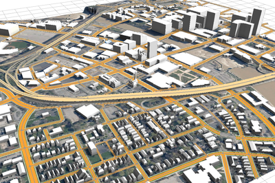

Here is a screenshot of my project if it helps. There aren't many textures other than the sidewalks. Some of the more detailed models like that chapel were imported into CityeEngine by a 3D Modeler who hand-made them in Maya. Thank you!
