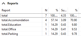

Like so:

Thanks for your question. To create group reports based on an object attribute "Land_Use", you can concatenate the group name "total" with the string attribute value of "Land_Use".
attr Land_Use = "empty"
@StartRule
Generate -->
	report("total."+Land_Use, geometry.area/10000)
 This should yield the desired result:
ThomasFuchs
Hello @AlexWierzbicki
@StartRule
Generate -->
