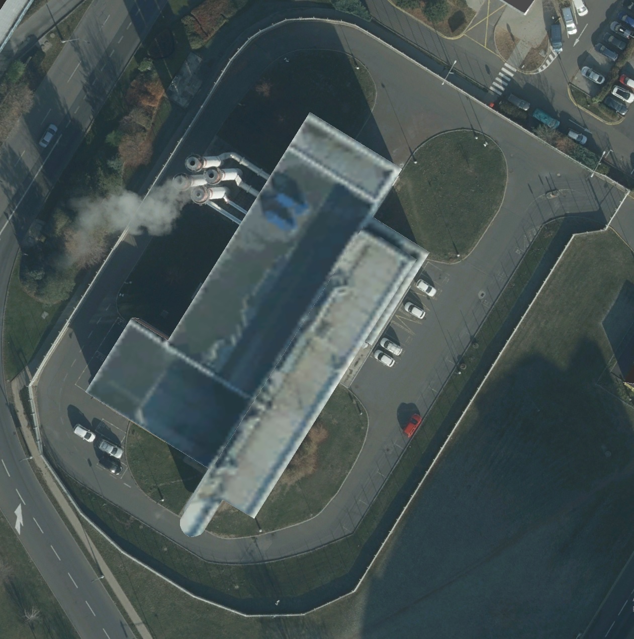

I have a problem with texturing the roofs of buildings. I have orthophotomap with resolution 5cm (25000 x 20000 pixels) and buildings.

The roofs were textured, but their resolution is low. I send pictures original orthophoto and textured roof for example.
Is there any way to get the same resolution on the roofs?

CityEngine does not support 25x25k textures. It works different as a GIS system that only loads what is visible for the screen space. In CityEngine, this entire (huge!) file has to be loaded onto your graphics card which certainly has not enough memory.
This is a precaution measure of CityEngine. Please reduce the file to 6000x6000 pixels (cells), then it should work, otherwise go even lower (4000x4000). Use this lower resolution as a temporary file to work with in CityEngine and in the end, in your target application, go back to the full resolution (if it is supported there).
