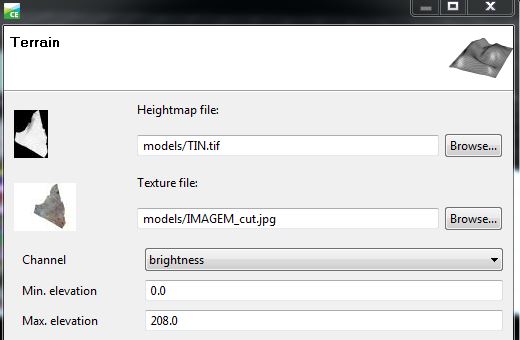

Luiz_AmadeuCoutinho
Hi Diego
For example,  I have a TIN.tif and a "picture" of my TIN in jpg format.:
