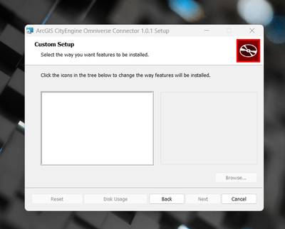

trial cityengine installed in D:/ repetory
Une erreur s'est produite lors de l'installation de ArcGIS CityEngine : Command failed: "C:\Users\my space\AppData\Local\ov\pkg\esri-connector-1.0.1\esri_install.bat"

Hello & thanks for your interest in CityEngine and Omniverse.
Which version of CityEngine Trial did you install? The empty list in the screenshot suggests it is neither 2021.1, nor 2022.0.
Unfortunately, version 2022.1 is currently NOT yet supported by the Omniverse Connector. The latest supported CityEngine version is 2022.0. We are working on the update.

hi thank you for the answer, the version is 2022.1 and is installed in D:\ i think this is the probleme

Ok. We just submitted the connector for 2022.1 to Nvidia - if it passes their tests it will be released soon.
