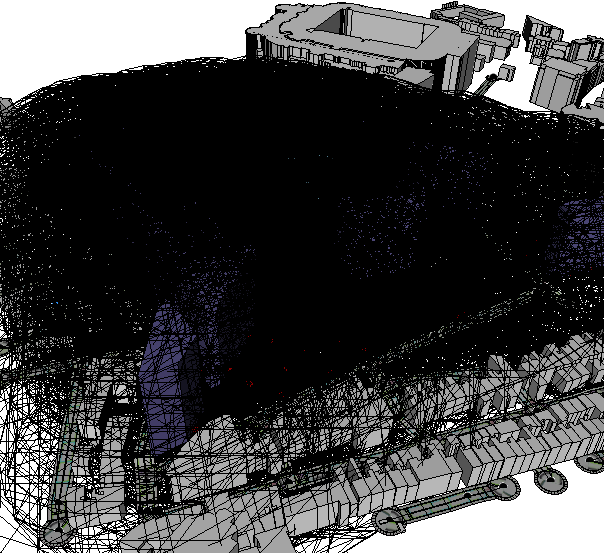

I have added a 3D buffer to my CityEngine Scene, and have managed to change to opacity. However, ideally the buffer would be coloured and the edges would be less prominent. If anyone could advise me on how to achieve this that would be great!
I have attached images and the code I have used so far.

You could turn the wireframe rendering off by either pressing 7 in the viewport or selecting it through the gear icon on the top right corner of the viewport -> "Wireframe on Shaded/Textured".  (You could turn it back on the same way; it is a toggle switch.)
You could use color() to set the color and opacity in one command:
