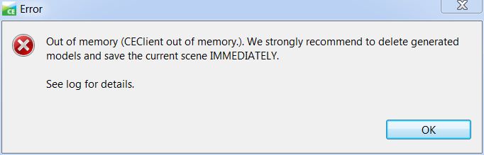

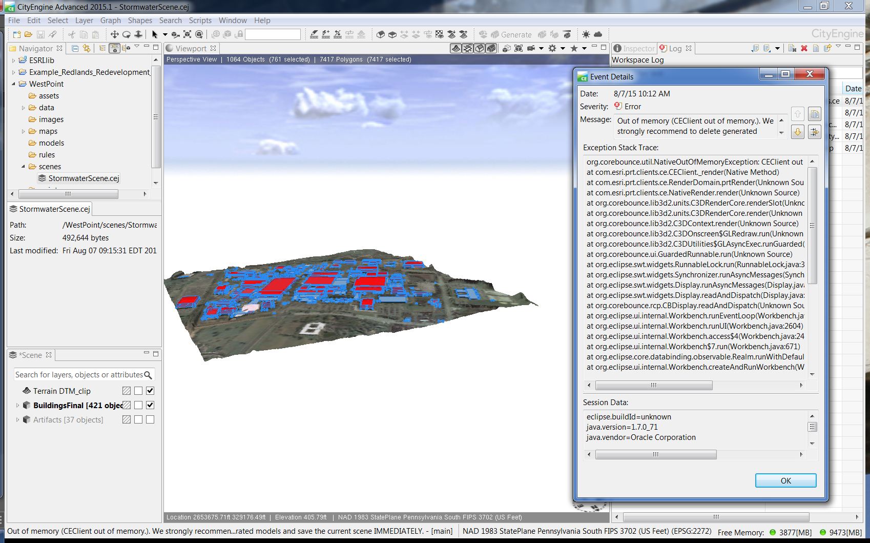

I have a scene with just 421 buildings and a terrain. When I apply the Zoning.cga rule right out of the Redlands Redev example, this warning pops up almost immediately. The buildings are generated from a feature class prepared in ArcMap 10.3 which was developed from a plan drawn in AutoCAD. What is the issue here? I have the numbers 3807[MB] and 9476[MB] in my Free Memory bar in CityEngine and that indicates to me that there is enough RAM available. I just upgraded the version from 2014 to 2015.1 and continue to get this error so I am at a loss as to how to proceed. Help, I need to generate models! What is the solution? Log and screen shot are below...

If the proplem occurs with 400 ish footprints, it could come from one single footprint.
Depending on the code, it could be an 'endless recursion' or a geometric/topological issue.
Veronica, can you try and track it down by eliminating elements that don't seem to cause this issue?
Make a duplicate of the scene file, then:
- delete terrain
- generate models 'per rule file' (if there are multiple rules involved)
- also, analyze, if the issue comes up when you generate the models multiple times, having an eye on the right mem-indicator.
- you can also do a 'binary search', generating half the models. if that goes well, the other half. if you run into an issue with one of the halves, go to a quarter of the scene, and so on.
I've had it in the past that one 'sliver' shape that was 1 meter long and a fraction of a cm wide caused the exporter to crash. binary search was the method to find that shape.
