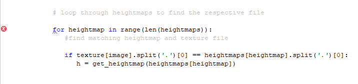

leehwichan
from scripting import *
import os
# get a CityEngine instance
ce = CE()
# function to access the filename of a requested heightmap (.tif)
def get_heightmap(file):
return 'maps/dem' + file
# function to access the filename of a requested texture (.tif)
def get_texture(file):
return 'maps/texture' + file
def main():
# get a list containing all texture files (imagery)
texture = os.listdir(ce.toFSPath('maps/imagery_by_grid_blocks'))
# get a list of all heightmap files
heightmaps_all = os.listdir(ce.toFSPath('maps/dem_by_grid_blocks'))
heightmaps = [file for file in heightmaps_all if file.split('.')[1] == 'tif']
# for each image in the texture list
for image in range(len(texture)):
t = get_texture(texture[image]) # get the texture image
file_name = texture[image].split('.')[0] # this becomes the file name
# loop through heightmaps to find the respective file
for heightmap in range(len(heightmaps)):
#find matching heightmap and texture file
if texture[image].split('.')[0] == heightmaps[heightmap].split('.')[0]:
h = get_heightmap(heightmaps[heightmap])
ce.addAttributeLayer(file_name, t, h, True)
print (file_name + ' has been added.')
if __name__ == '__main__':
main()
I wrote the script as above and I get the same error as in the last picture. I want to know the reason.
