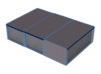

LR
Thanks - I ended up using my rule because it allowed bulk alignment and used your suggestion for the roofs since they didn't accept world.*.
However now I'm looking for a way to do that - fixing wrong roof(s) is pretty time-consuming in large areas.. any idea how to align the roof to cardinal directions? This is how it usually looks like when I generate a row of buildings:
