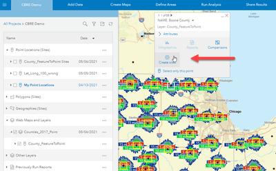

After creating your drive time buffers, if you want to save them as sites in your project, please click Create sites here:

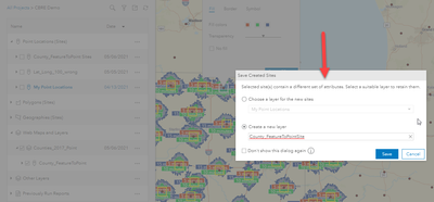

Then you will be prompted to save these sites as a new layer or into the default My Point locations layer. I recommend creating a new layer if you have attributes from the point layer that you want to keep:

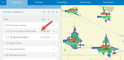

Once you save the new layer, it will be listed as a new point location layer in your project here:

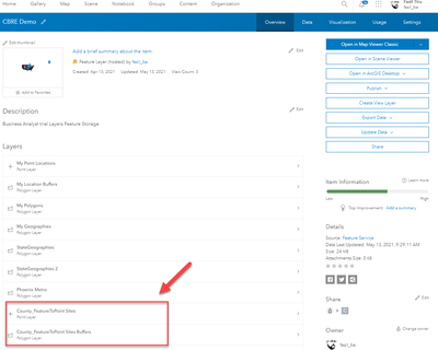

Then if you want to access these layers in ArcGIS Online, you will see it listed under your project:

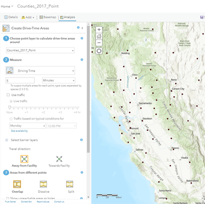

You can also simply create drive times and rings on your point feature layer in ArcGIS Online map viewer using the Analysis tools:
