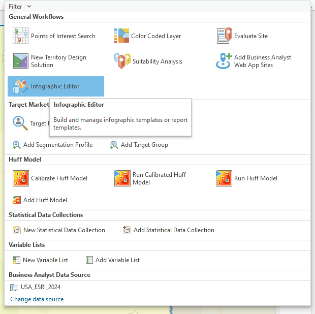

BA Pro supports the same report and infographic editing as BA Web. It is the same user experience but loads locally installed templates (or BA Web if using Online as the portal).
You access the editor from the BA ribbon

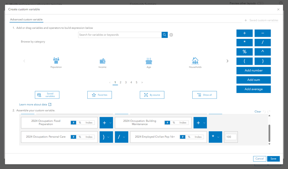

Open any of the templates. The Community Summary uses custom variables to define jobs. When you edit the panel you can see the variables used within it
Editing an individual variable opens us the calculator. You can see how a variable like Services is made up of a set of variables and calculations. Use the calculation editor to change or create custom variables.
The variable name can be edited in reports or infographics. and persist across years of data.
