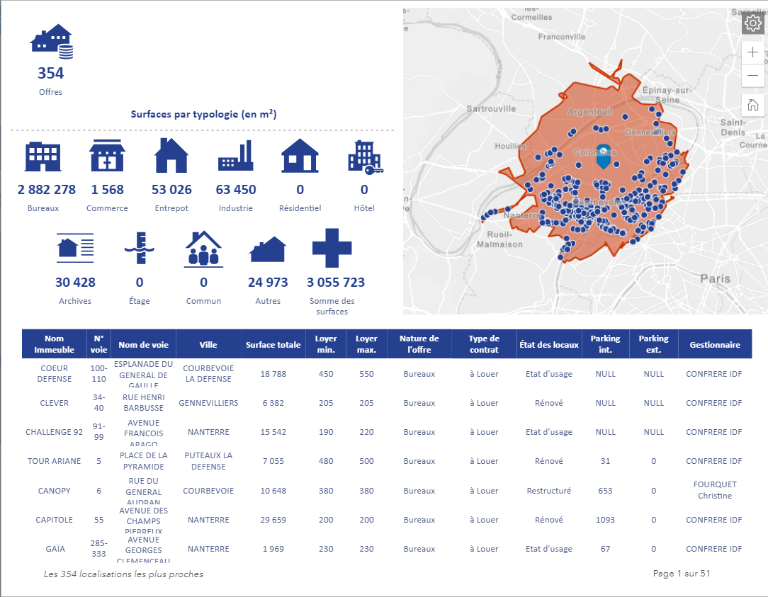

Hi,
I've a problem with my infographics. I created custom data to manage the numeric things on infographics panel, and I used the Nearby location panel to add text data on a table.
So, actually I try to create a count with the Nearby location without filter : it works.

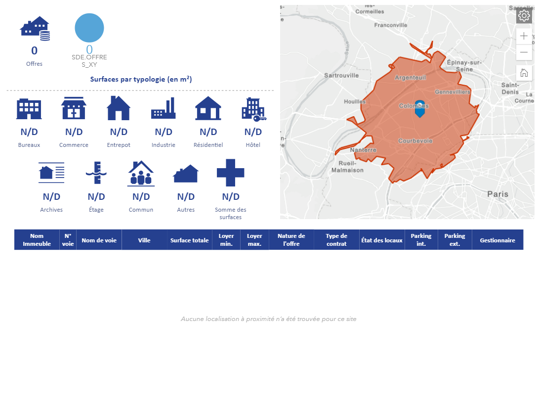

But, when I want to add a filter on my data (setting on the nearby panel), all of the infographics bug.
It is a knowledge bug ? i miss something ?

Filters work on both Esri data and you own custom data. We use filters in the What's in my Community infographic. Which you can open and edit.
 I notice that your other data is not being summarized either. Can you send a copy of the template as a BRPT file to us via the upload button below? You can save the file and then we can look at it.

Hi @HelenThompson I found the problem. In my field I have one element "Etat d'usage", the " ' " character create a problem of reading in the filter. So to avoid this problem i have to write "Etat d''usage".
