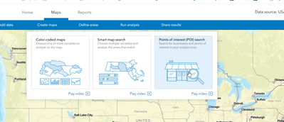

Hello BA Community:  Prior to the update, I was able to generate a layer showing points of business locations. Now all I have access to is a pdf of business locations. What am I missing? Is the option for business location points still available?

@MelanieNeedle Thank you for confirming. In BA Web App, you can use the Points of interest search to create a layer of business locations. Are you able to see this option?

Solved! Thank you!
