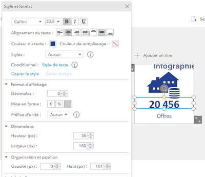

Hi, my question is simple, how can i set some different units that can I use on my infographics ?
I have nothing else than € and % ?

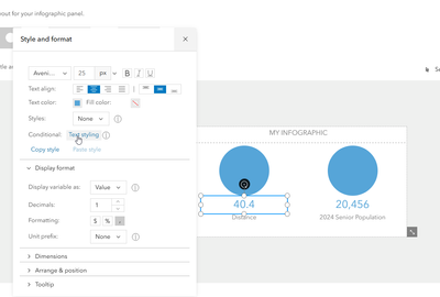

@JasonBOCQUET Thank you for the additional details. I can see how being able to define your own units would be helpful, especially when working with custom variables. This may be good enhancement to the infographics builder in the future.

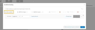

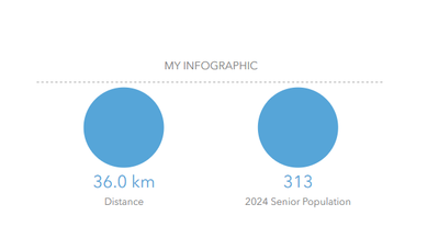

For now, I was able to use Conditional styling to achieve the same goal. Here are the steps you can try:
1. When editing your variable, use the option for Text styling
2. Add a condition that will include all results for the variable

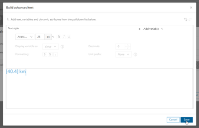

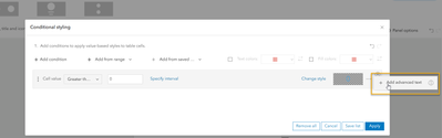

3. Use the option for Add Advanced text
4. Add the value for the variable
5. Add your unit to the text and Save
6. When you run the template you will see the variable value with the text you added

Hi @JasonBOCQUET Thanks for the details of your question. The format options you see in the builder are based on the particular variable that you are configuring. Only options that are compatible with that variable will be seen.
Which type of units are you interested in adding to your variable value?
JasonBOCQUET
Hi @CherylHagevik thanks for your reply. I have a lot of units that i want to use. For example square meters (m²) or €/m²/year
quick list : km, km², hab., étab. and some other things like that
How can I configure my variable to have other format option ?

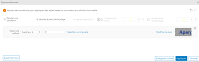

JasonBOCQUET
Hi @CherylHagevik
I want to follow your tutorial but...
I have not the "3 dot" option.
I'm on Enterprise 11.1, i have not access to this feature ?
CherylHagevik
@JasonBOCQUET This feature for Advanced text was added about a year ago to Online and became available starting with Enterprise 11.3.
