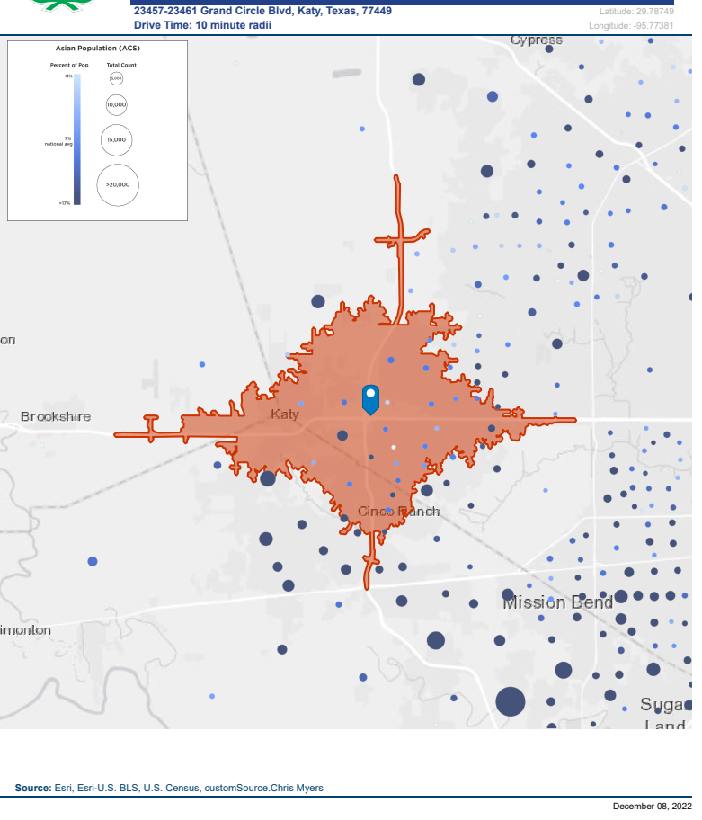

Hello,
I would like to know if it is possible to have a legend added to a map that has been placed in a custom report? I am building a custom report on Business Analyst Web App, and I have a page that I've placed a map item. I've added a layer to the map item. However, when I run the report for a site, there is no legend on the map, which makes it much less meaningful. I cannot figure out a way to add this feature.
Please see screenshot.
Thanks,
Chris

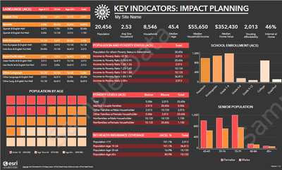

For example, you can see the various tables on the second page of the Coronavirus Impact Planning template.

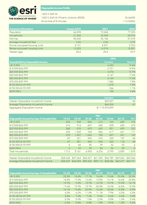

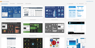

Here is another example called Disposable Income Profile from the infographics gallery we built using build infographics workflow:
I have attached this sample template below so you can explore how to create compelling tabular reports using infographics.

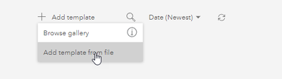

After extracting, you can import this sample templates (.brpt files) by going to Build Infographics > + Add template > Add template from file.

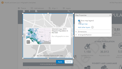

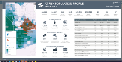

I recommend building your report using infographics as it already provide much more functionality including legends.
Your legend will appear as follows:
Currently, we don't have a legend option in classic reports but we will consider it as an enhancement request for the future.

ChrisMyers_NewQuest
Since there is no current work around for adding a legend to map in a custom report (besides using infographics instead), my current workaround is to build a legend my hand and place on the map as a floating image:
Thanks,
Chris
