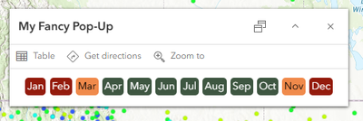

HI, I am trying to re-create this in an EB pop up
So far the best I can do is this kind of thing.
Its not ideal as we want the whole year in one row.
Just checking to see if anyone has a better idea.
We have over 100 points that require this data to be displayed.
Thanks!

You can create your desired style using the Arcade Content Block and HTML.

You may need to adjust the sizing a bit, but that should get you on the right path.

Jen this is great! I only just read your post, will give it a go right now.
Thank you!
