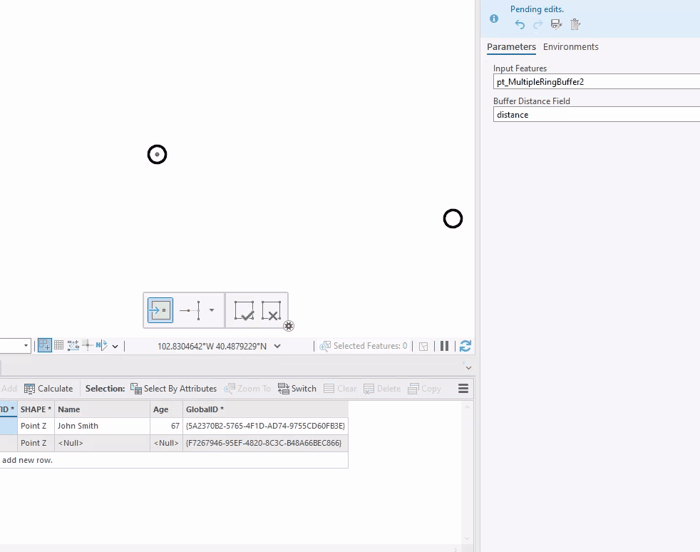

Not sure what the issue is.
I copy-pasted your code directly into a test pair of points and it worked great (I did change the fields and the featureclass value, of course).
Caveat is that I tested in a file geodatabase, which of course raises the question of if you still have trouble if you test in one as well? (Also if that table actually exists/ you have edit permissions there?)
