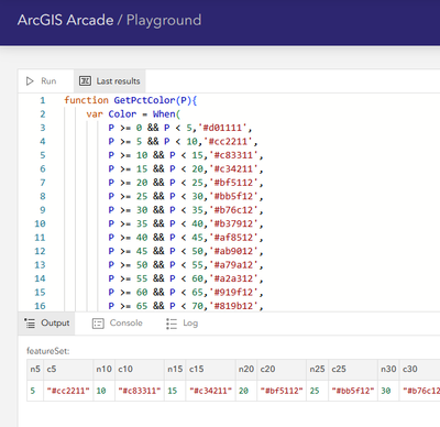

It is ultimately, when combined with a modified html, to look like this.
