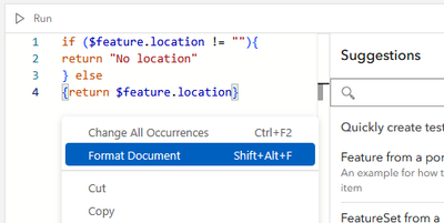

You can apply standard linting rules (which includes indenting) to your code with Shift+Alt+F or right-clicking and selecting Format Document.

Your suggestion unfortunately does not work in pro. In either arcgis online and enterprise portals it does indent but the pro version does not.
