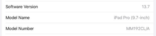

Following is the configuration of our testing device:
