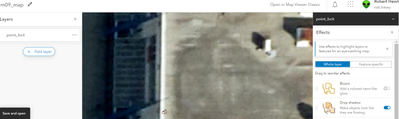

rob_hewy
Layer effects definitely blows up the map; Knocks-out the version number
I only tested drop shadow.  UPDATE: Bloom causes problems too.
qml: ==================== GIST 8010 ==================
qml: ===== Version:
qml: ==================== WAR  END  ==================

rob_hewy
Turn the effect off then save and the map works again:
qml: ===== Version: 2.24
qml:
