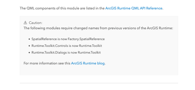

I am working on updating an old AppStudio project that is referencing 'ArcGIS.AppFramework.Controls 1.0' that is importing a 'FooterBar'. Looking in the qml environment it seems that this is not in the folder structure of the environment and referencing the AppFramework docs it seems that this is not a part of the current environment.

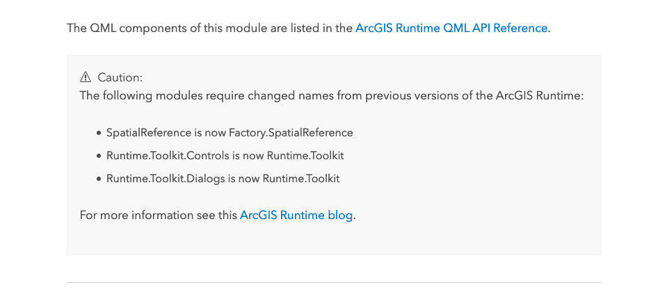

At the end of the article about AppFramework page there is a reference to importing Controls and how it has been changed, but the blog post that it references doesn't reference this.
The project was created around July 2015 and I am looking to update this. Where did the Controls imports move to?
