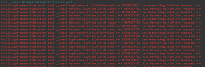

I have only 1 more error.
Can you provide more information to solve this?
Im using the NetworkRequest Type from ArcGIS.AppFramework 1.0.
