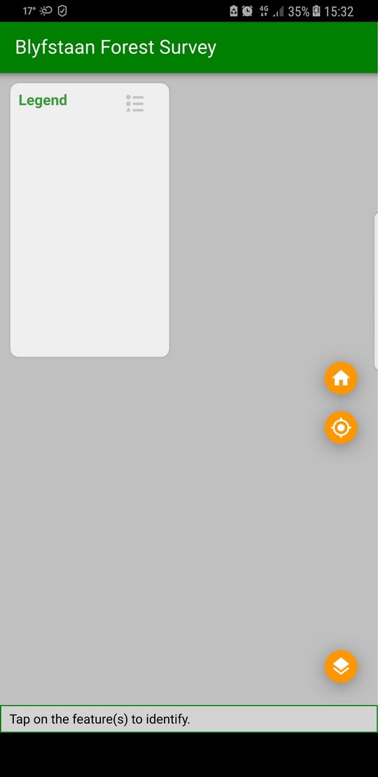

I have been able to piece together an app from samples and tutorials. The app runs perfectly in AppStudio for ArcGIS and in my AppStudio Player on Android. But when I actually build the app and create both an APK and EXE file for windows,  it seems as if the MMPK no longer loads in the APK app. However if I install the exe file on Windows, then the mmpk loads perfectly with the app.
The below image shows the app unable to load the mmpk after creating the apk.

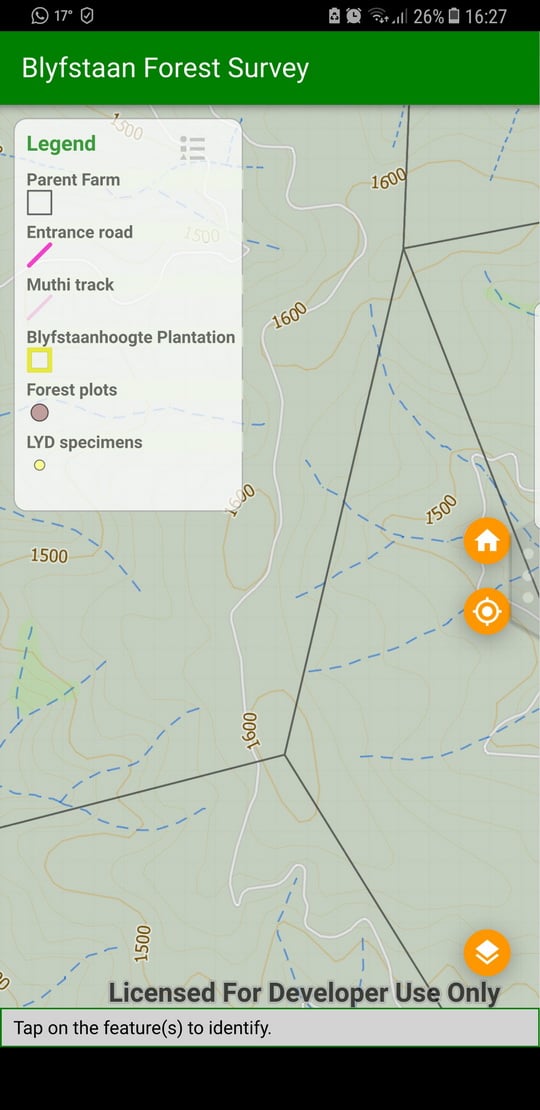

The below screenshot is from the AppStudio player with the mmpk loading perfectly. Same experience on Windows with built app.

Could you please double check if you have enabled  the external storage (capability from App Settings )in your app? This is required for Android device and not really for windows device. The player already has this enabled by default.
You can also test your mmpk by adding it to the Open Mobile Map mmpk sample and make sure it works.

The problem was that I had not activated the external storage capability. Thank you so much for picking that up! Much appreciated.  Working perfectly now.
