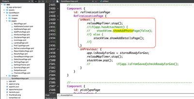

If there is no attachment in the feature layer, the "AddPhotoPage" will be skipped and it will go to AddDetailsPage after the map page, as shown in the code at QuickReportApp.qml ~ line 2486 inside the Component refineLocationPage onNext. You can also make just comment the section to simply call stackview.showAddDetailsPage() in the onNext. This works using the sample data where attachment is not required.
I hope this is helpful,
