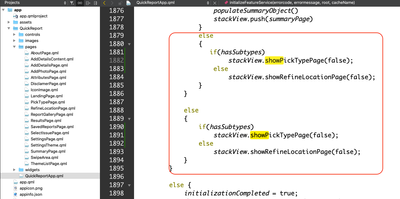

I think the best way to skip the PickTypePage is to remove the subtypes in your feature layer, there is already a logic in QuickReport template to skip the PickTypePage when you don't have the subtypes in the feature layer. As shown in QuickReportApp.qml ~line 1881 and ~line1890. We can not easily remove this check since the value type is required if the feature layer has subtypes.
I don't think the submit button is tied into the attributes, but please check if there are any required fields in your feature layer.
