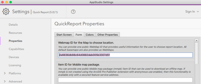

1) The map you see in the Quick Report is reading the web map ID from Settings > Form > Web map ID for the Map to choose locationWe provide an empty map by default. That's why you didn't see your points on the map.
To show your points on the map, you will need to create a new web map with your feature layers in it and then provide the web map ID here.

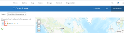

2) You can change styles by changing visualization settings for your feature layer item in ArcGIS Online or Enterprise.
First, open the feature layer item in ArcGIS Online or Enterprise > Visualization tab > Click on the change style icon in the left panel to change the style > Save
This style should be reflected in the Quick report template.

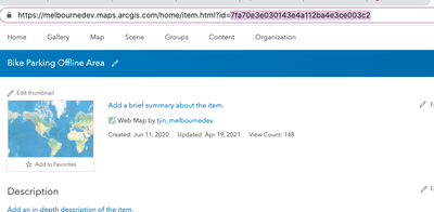

3)  To find web map ID, open the web map items in the ArcGIS Online or Enterprise. You can see the web map id from URL.
