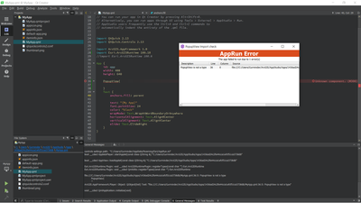

Hi team,
We were using ArcGIS AppStudio Desktop 4.8 where we built an app using the quick reporter template.
We customized the app using PopupView by importing
import Esri.ArcGISRuntime.Toolkit.Controls 100.8
However after the latest update to ArcGIS AppStudio Desktop 5.0 its seems the PopupView type belongs in
import Esri.ArcGISRuntime 100.10
https://developers.arcgis.com/qt/toolkit/api-reference/qml-popupview.html

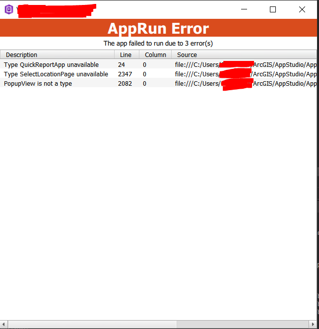

Even after importing ESRI.ArcGISRuntime 100.10 I have been getting error stating:

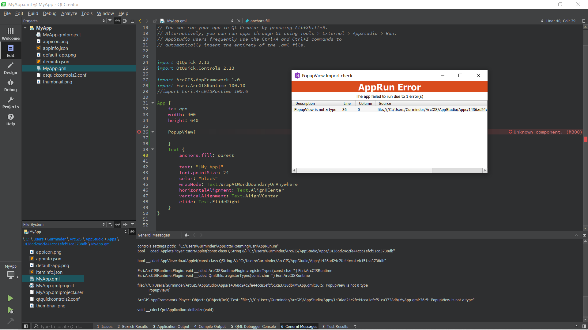

I can repoduce the issue with am simple app attached to thread:
Any suggestions would be great!
SeanKim
Import 'toolkit' should works.
import Esri.ArcGISRuntime.Toolkit 100.10
SeanKim
BrentSlone3
Thank you for replying, this works like charm.
