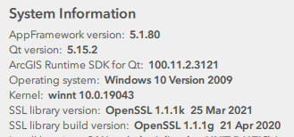

GKmieliauskas
Hi,
I am running AppStudio 5.1.80. Other system info below:
Timeout longs about 20 seconds
