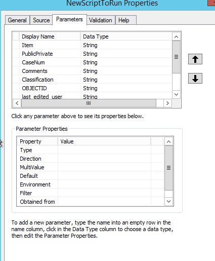

I created a Toolbox
I created a New Script
I then set parameters for each of the fields I want to update
I then modified the python file as such:
When I run the tool I can add values in the attribute fields from the popup window and it updates fine...
I just don't know how to pass the parameters from inside AppStudio to the GP Service.....
