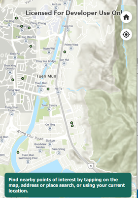

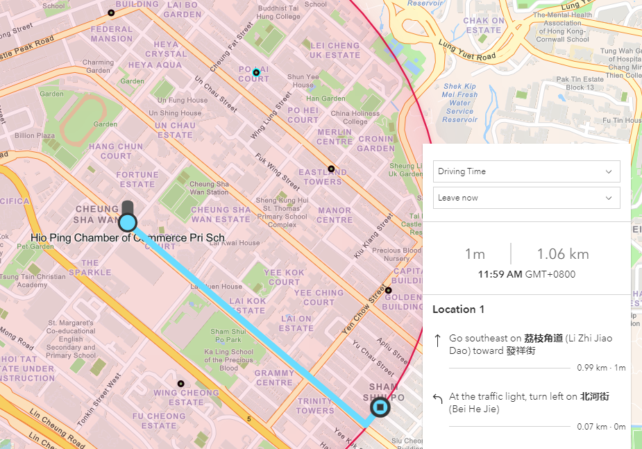

Q1. Is the routing service mainly for car? I want to get the direction from gray point to selected blue point (item 8195)
Environment: Instant App (Webapp).
A route is suggested driving out of the filtering zone.
When I change it to walking distance. It is still taking a route long than my expected walking path (red)

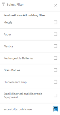

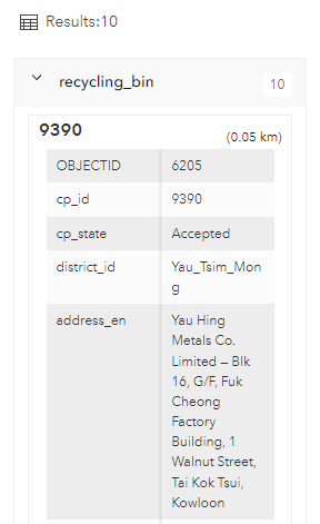

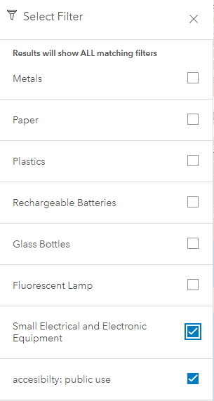

Q2. The filter (AND) behaviour is different in instant app and appstudio

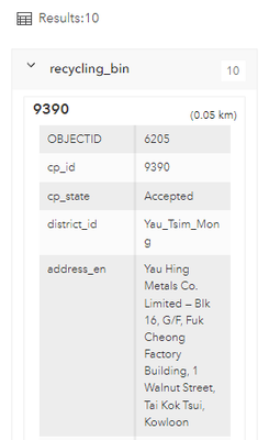

A) Environment: Instant App (Webapp).
Typefilters selectedfiltered resultscounts
137
10
8
The outcomes are decreasing in number (expected)

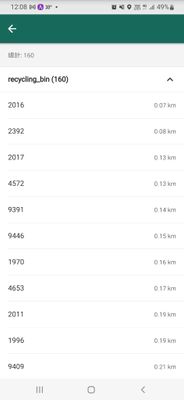

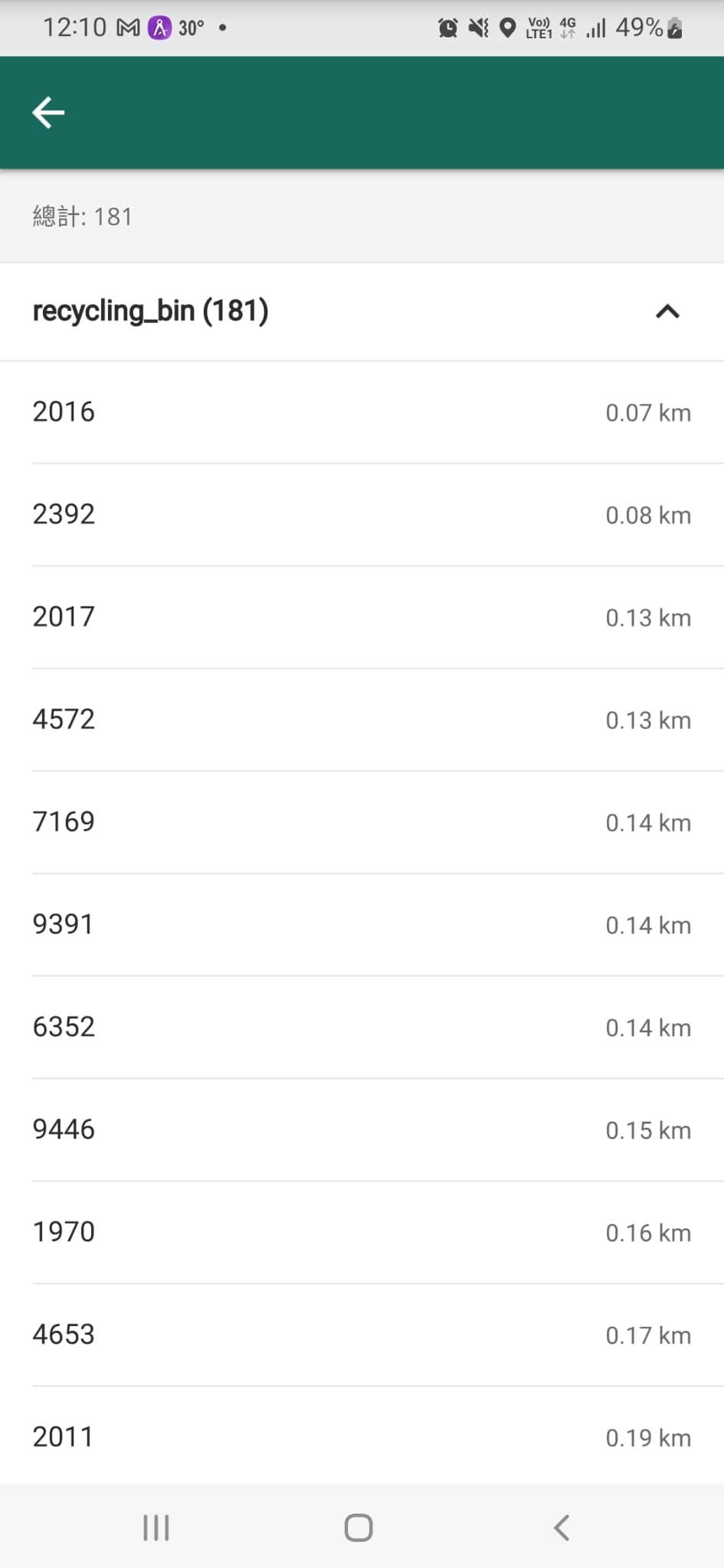

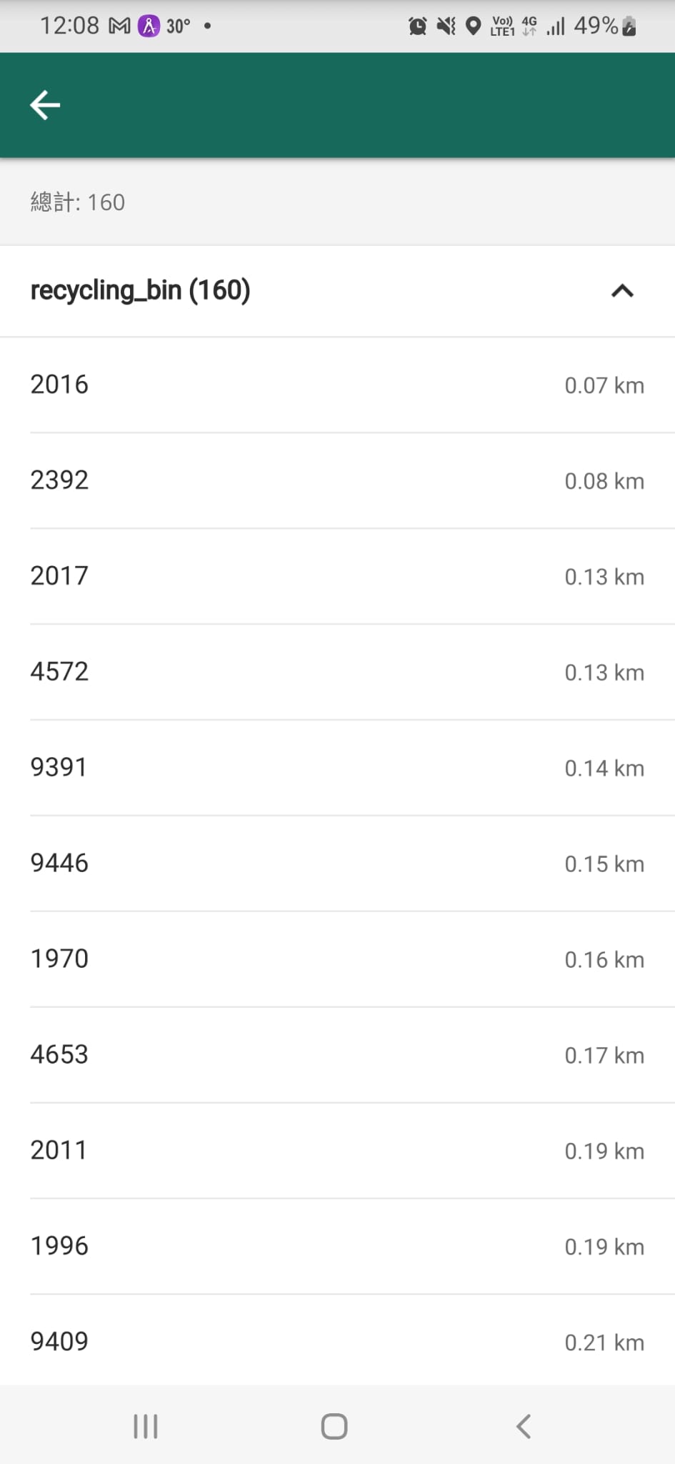

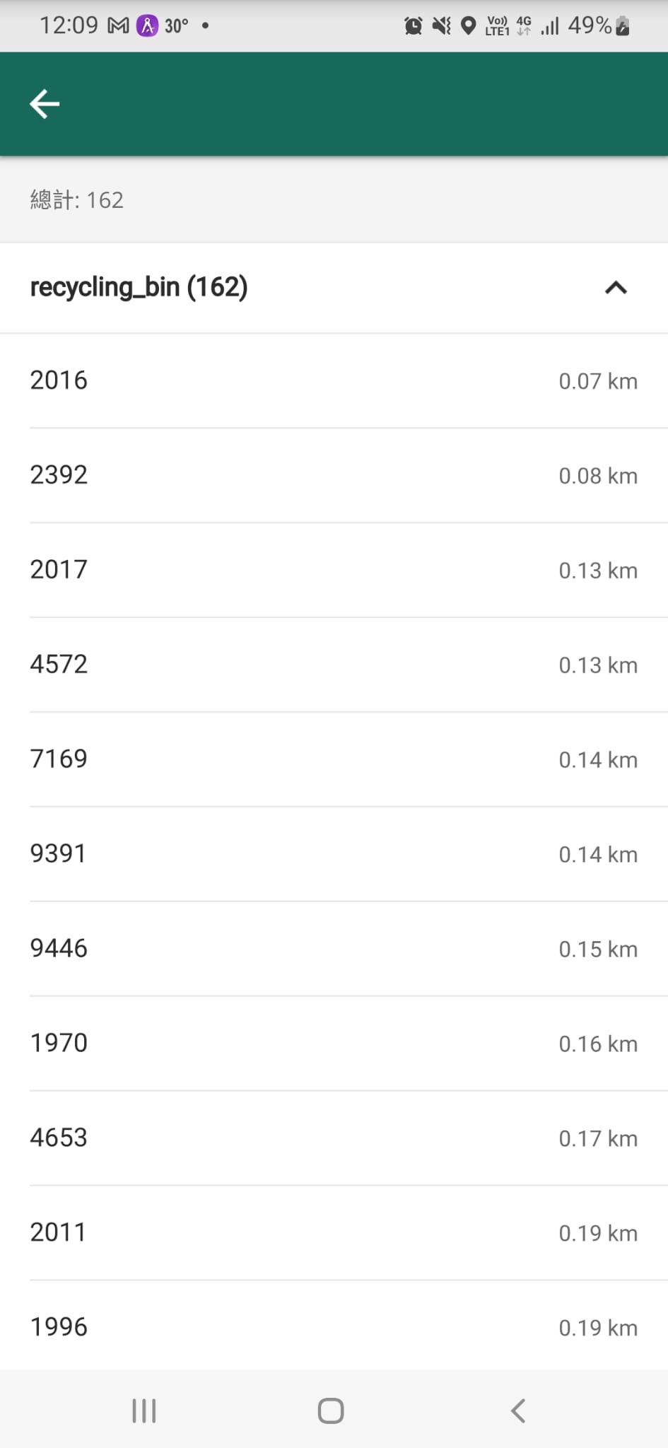

B) Environment: Native App (Appstudio). Testing in Appstuido desktop and player
1 filterFelix10546_3-1654143559952.jpegFelix10546_4-1654143613550.jpeg160
162
181
To outcomes are increasing in number! (Is it a bug?)

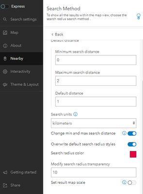

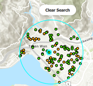

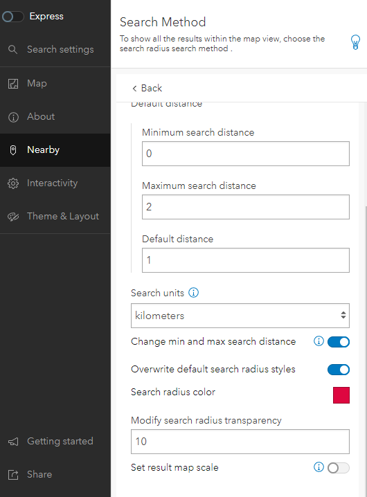

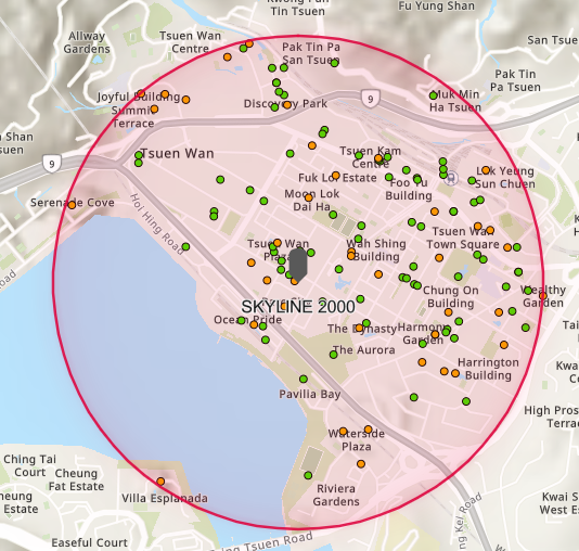

Q3. effect of "Search radius color" and "transparency" is not applied to the Native app by Appstudio
webapp (Instant app)native app (App studio)

As for Q1 about the routing, it appears the selected point to route to is still the feature in the bottom right portion which would take that straight blue route and not the red route regardless of walking or driving.
