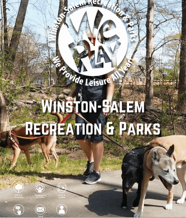

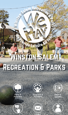

Hey all,
I am new to QML and am trying to create a grid of buttons that stays centered on the bottom third of the page that will also scale depending on screen size and DPI.
I am sure I am missing something with the anchors and bottom margins and how to use scaleFactor but I'm unsure where I am making a mistake.
The images below show how I would like for the app page to look and how they are actually looking with my current code.
The code has been attached as well.
Ideal Design
Ideal DesignIdeal Design
Actual Code - Note the buttons are being cut off at the bottom
My Code DesignMy Code Design
Actual Code (window size scaled)
Actual Code (scaled)Actual Code (scaled)

Any help would be beneficial.
Thank you!

Hi @JoshBillings ,
You're actually really close! There is another anchor you can use in the gridlayout such as:
anchors.horizontalCenter: parent.horizontalCenter
and get rid of the left anchor and margin. This would make it so it is always anchored to the bottom and center of its parent regardless of the screen size. Also, get rid of the height and width in the gridlayout as that could cause an issue with the area the buttons try to fit inside.
That should do it for you.

JoshBillings
Worked like a charm. You're the man - thank you!
