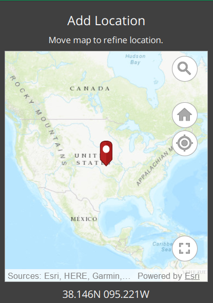

1. change the extent on mapview. Because, when we first open it, it shows the US, while I want it to show the location where I want my apps to be used

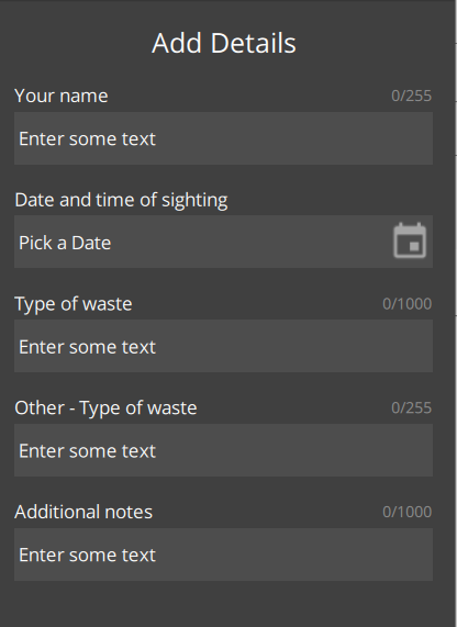

2. I also want to change the add details page, such as I want user doesn't need to type the type of waste, just select from options that I will provide, to prevent messy data collection, because I also want to publish the collected data into ArcGIS operation dashboard. I also want to remove the "other type of waste" column. I think this design has followed the design of my survey123 form. I have changed the style of the form, yet it doesn't change as the way I want

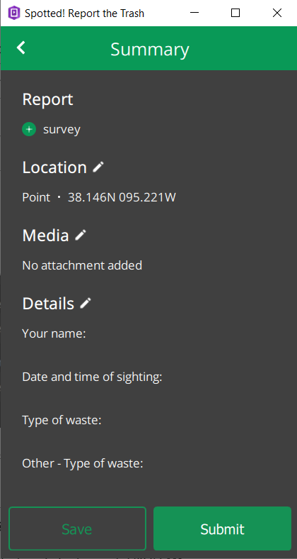

3. Lastly, is it possible to attach a map to show the point that the user has reported to us on the summary page?

For the question 1, that map is controlled by the Webmap ID that is in the Settings>Properties>Form>Webmap ID. I think by default it uses the webmap that we provided, feel freet o change this to your own webmap with the extent or data that you want to show.
For question 2, you can change that by changing the field in the feature layer, in order to have a dropdown list, you need to have a list of domain values for that field. And then the Quick Report template will automatically take the domain values and show as dropdown list.
https://community.esri.com/t5/arcgis-online-questions/drop-down-menu-for-attributes-when-creating-ed...
For question 3, it requires some customization in the code. I would like to point out the sample that we have called "Graphic Overlay" and choose "Graphic Overlay" in the option, that can be added to the page in Quick Report template, the summary page source code is located at QuickReport/pages/SummaryPage.qml.
