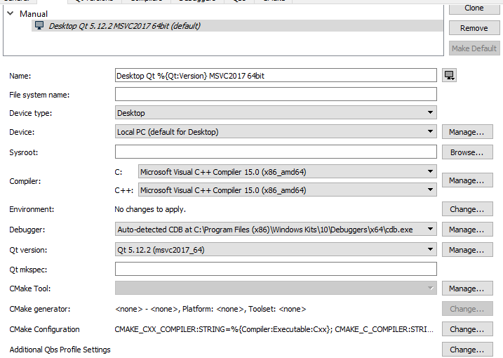

I managed to manually set up a kit. With the options that a menber of this support sended to me already.

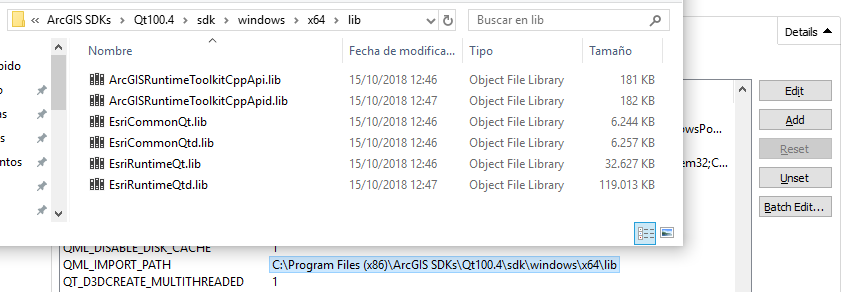

And I also Installed the SDK and added the Path to QT Creator as I show in the next image.
The problem appears when I try to edit the new project (created in AppStudio). When QT Creator opens I get the next error:

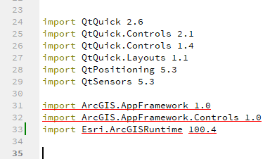

This dosent allow me to use this libraries so I can't see the text predinction but It's specially weird because when I use something from this libraries. It works as we can see here, where the "MapView" object dosen't display a compiling error message:
If i try to execute this code from QT Creator (Using the Bottom Left button or Ctrl + R) this displays the next error:
file:///C:/Users/seran/ArcGIS/AppStudio/Apps/e2df05ca652245aca55ff270ba0658c3/My
App.qml:33 module "Esri.ArcGISRuntime" is not installed
file:///C:/Users/seran/ArcGIS/AppStudio/Apps/e2df05ca652245aca55ff270ba0658c3/MyApp.qml:32 module "ArcGIS.AppFramework.Controls" is not installed
file:///C:/Users/seran/ArcGIS/AppStudio/Apps/e2df05ca652245aca55ff270ba0658c3/MyApp.qml:31 module "ArcGIS.AppFramework" is not installed
file:///C:/Users/seran/ArcGIS/AppStudio/Apps/e2df05ca652245aca55ff270ba0658c3/MyApp.qml:33 module "Esri.ArcGISRuntime" is not installed

Errors described in your above comment can be resolved by running the AppStudio Advanced Configuration tool. Advanced configuration tool copies a few files from the AppStudio install location to the Qt SDK folder.
