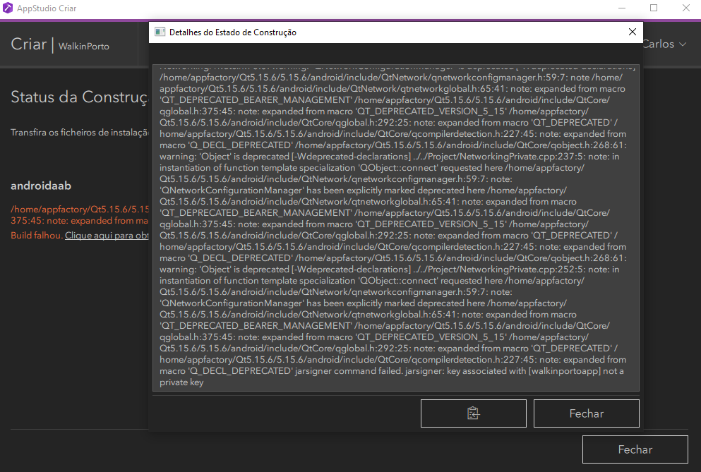

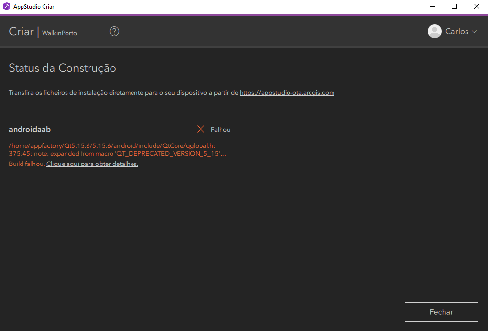

I am trying creating a new version of the AAB file and publish it. And it not finish the process.
Bellow a screenshot of the versions.
around 99% progress I am getting the error message bellow.
... the first error that I for was related with Framework.Sensors. I have commented the  line //import ArcGIS.AppFramework.Sensors 1.0  and now I am getting the error above.
I spent the whole day trying to find the lines where I can disable it and I couldn't find it. Attached I am sent the log details. I hope someone helps me understand this problem.
obs. If I change it to .apk its works fine. but .aab not works.
thanks

CarlosCarvalho
Hi @TrevorFrame,
I'm getting the same issue, I'm not able to create an aab bundle file for android (also doesn't work for ARM APK).
Can you provide support for this issue?
Thanks,
Carlos Carvalho

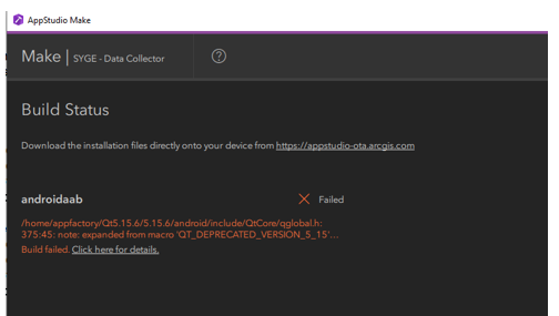

MistyDowning
Hi @TrevorFrame
I am still getting what looks like the same error trying Cloud Make. I have attached the full error response I get.  Any assistance or guidance would be appreciated.
Gracias,
Mysti
