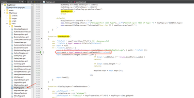

Thank you for reaching out. I can reproduce this issue and it looks like a bug in MapViewer template version 5.1. Can you help us log bug via Esri Technical Support?
Here is how to fix this, please add this one line code in MapViewer/views/MapPage.qml around line 8167 inside function openMapArea()
            mmpk.path = AppFramework.resolvedPathUrl(filePath);
