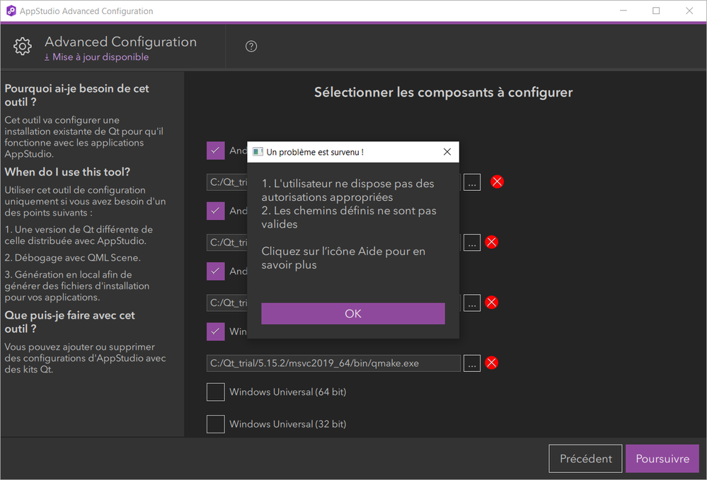

Hello,
I want to perform local Make instead of cloud Make to generate binaries for my apps.
So i created locally installation files for an Appstudio 4 application for Android on Windows 10 Enterprise.
For that i installed development tools locally following the official doc
ArcGIS AppStudio 4.0.93 (64-bit)
Visual Studio 2019,
Qt 5.15.2 for Windows (VS 2019) and Android (64-bit)
Android SDK Platform Tools and Android SDK
JDK8
When i try to configure with qt kit for arcgis appstudio, i'm having an error saying "either the user does not have the appropriate permissions or the defined paths are not valid"
I opened AdvancedConfiguration.exe with my local admin account and redo the configuration: same error.
It is therefore not linked to the rights of the Windows account.
For info, i'm using a trial commercial licence for Qt SDK.
I don't know if you were able to set up the right environment for the local generation.
Do you have any idea how to solve this?
