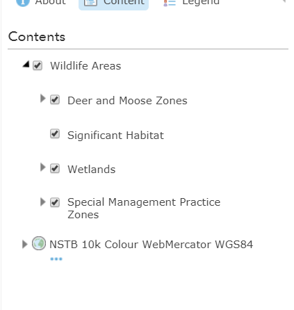

I am trying to add a layer that I have created from a map service. The layer is easily added to a web map using the online MapViewer in my org account. The map layer consists of multiple service layers. The result is as seen below:

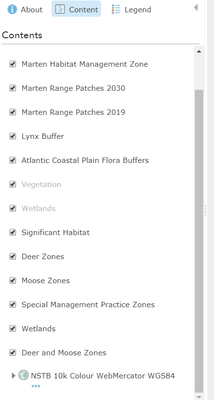

When I try to programatically add it to the web map using add_layer, I get the following:
It breaks out all the layers individually from the service itself. Code is below for creating the layer from the service and creating the webmap and adding the layer to it.

René_Ténière
Anyone know if there is a way to show only the main layer in the TOC so it looks like the webmap created in the online mapviewer?
