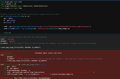

Hello,
I am using the notebook provided by the documentation but when running the code i keep getting this error. It seems some of the code has been deprecated. The documentation in this exercise may need to be updated.

Hi @OscarGaleas,
What version of the API are you using?
import arcgis
print(arcgis.__version__)
The Map class came in as of 2.4.0 replacing the WebMap class. So make sure you are on  2.4.0+.
Although, when setting the basemap it would look more like below, accessing the BasemapManager and then the basemap property.
m.basemap.basemap = b
