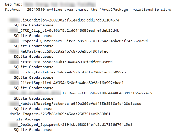

The successful processed web maps output the following:
I have been trying to look at what is the difference with the web maps that work fine and what is the difference with the ones that does but can't figure it out. Does anyone have any advice here?
