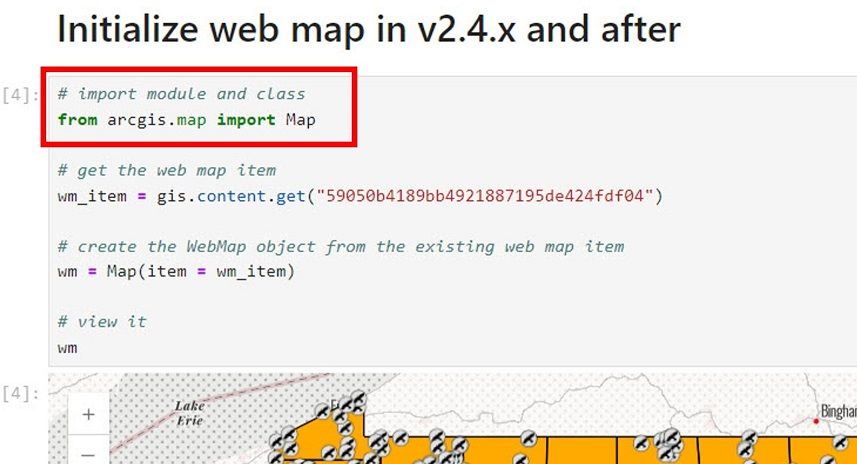

I'm basing my code on what I found at https://www.esri.com/arcgis-blog/products/api-python/announcements/whats-new-in-arcgis-api-for-pytho.... Specifically,
I'm guessing I'm missing something obvious; so any suggestions are welcome.
