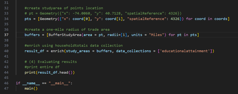

Here is my code:

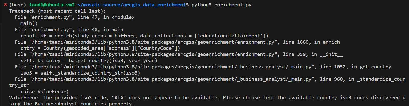

Here is the error message:
How do I specify the U.S. iso3 code?

Are you setting Country to "ATA"? Thats what the error message is saying. Below is how I ensure that USA is the Business Analyst dataset being used. What country are you intending to use?
