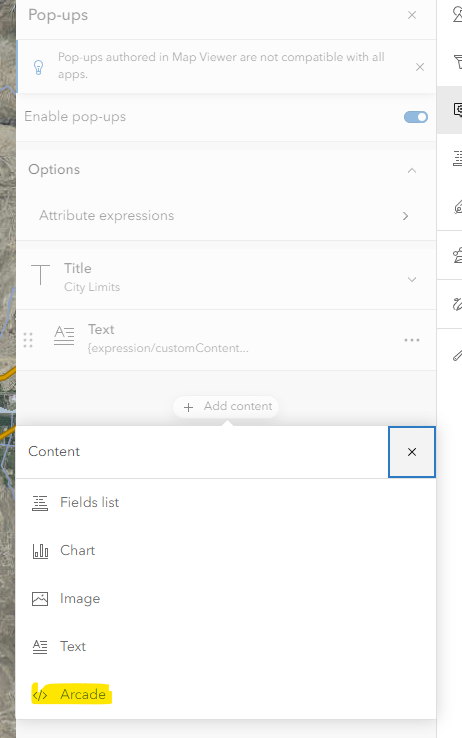

I am trying to batch-update multiple layers to all have the same Arcade content applied. I have found documentation on using a combination of Attribute Expressions / Text elements, but for the particular Arcade I am using, it only functions correctly if Arcade content is applied.
I have looked through the developer documentation and it does not appear to call out Arcade as a popupElement supported function.
Here is my current code, but ultimately I would like to remove the Attribute Expression and Text element and use Arcade as this works for hyperlinking out to URLs.

When I apply the below in an Arcade content section, the hyperlinks work. Whereas if I do it in an Attribute Expression and Text content, everything but the hyperlink works.
var fieldsToExclude = ["OBJECTID", "SHAPE", "LAYERNAME", "GLOBALID", "SHAPE.STAREA()", "SHAPE.STLENGTH()", "CREATED_USER", "CREATED_DATE", "LAST_EDITED_USER", "LAST_EDITED_DATE", "LASTMODBY", "LASTMODDATE", "LASTSYNDATE"];

Hi @Brian_McLeer
Seems like you were very close. The expressions element is the Arcade element that you see in the documentation
My go to is to do it manually in a WebMap and then grab the JSON from the definition for that layer. In your instance you only want an expression element in your popupElements that reflects your Arcade.

I'm really only interested in the popupElements as I only want an Arcade expression controlling the Popup.
