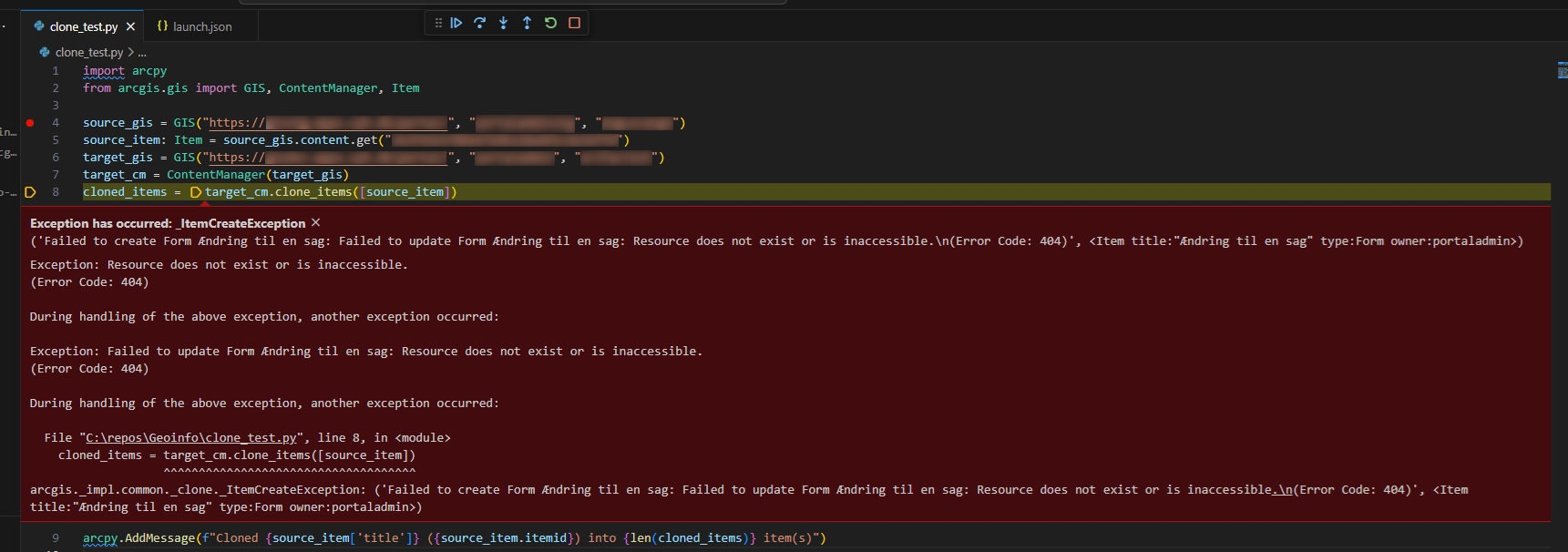

I am trying to clone a Survey from one ArcGIS Enterprise Portal (not Online) to another. But, I get the following error:
"Resource does not exist or is inaccessible. (Error Code: 404)"
I'm connected to both portals with an admin user, so I'm able to create a Survey. I've tried using the UI on the portal and it got created without issues.
Has anyone seen this kind of error before when cloning items?

I have verified it. For me also it didn't work and neither it's throwing any error. However, I have tried it with  below code.
target.content.clone_items(items=tester_content, folder=output_folder.name)
For more info refer below url.  https://developers.arcgis.com/python/latest/guide/cloning-content/
I htink there is some bug with these two modules. Please reply to this post If anybody has got any solution
